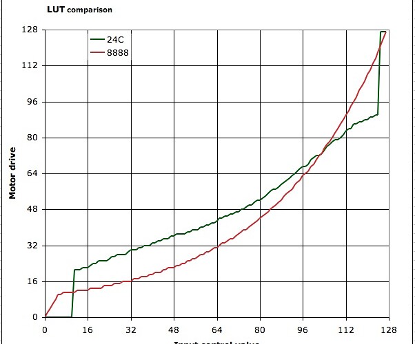

That’s good work Jordan, our team did use something similar during the Gateway season but pulled it out last year. For Sack Attack we did use a LUT as part of the PID control code, the motor drive value was linearized but this was calculated using a log function as part of initialization rather than having a fixed LUT. Here’s a comparison between your data and the curve I used in the PID code.
[ATTACH]7492[/ATTACH]
I did compare 393’s and 269’s at one point, they were pretty similar, but be aware that there is a small difference between how ports 1 and 10 work and the other 8 using the MC29s.

Not sure I understand the question, the LUT (lookup table) used by the 8888 code (red line on graph in post #8) was a power function calculated as follows.
// lookup table to linearize control
#define PIDLIB_LUT_SIZE     128
#define PIDLIB_LUT_FACTOR  20.0
#define PIDLIB_LUT_OFFSET    10
static  short   PidDriveLut[PIDLIB_LUT_SIZE];
void
PidControllerMakeLut()
    int   i;
    float x;
    for(i=0;i<PIDLIB_LUT_SIZE;i++)
        // check for valid power base
        if( PIDLIB_LUT_FACTOR > 1 )
            x = pow( PIDLIB_LUT_FACTOR, (float)i / (float)(PIDLIB_LUT_SIZE-1) );
            if(i >= (PIDLIB_LUT_OFFSET/2))
               PidDriveLut* = (((x - 1.0) / (PIDLIB_LUT_FACTOR - 1.0)) * (PIDLIB_LUT_SIZE-1-PIDLIB_LUT_OFFSET)) + PIDLIB_LUT_OFFSET;
            else
               PidDriveLut* = i * 2;
        else
            // Linear
            PidDriveLut* = i;

There’s actually nothing strange about the MC29 or cortex motor control per se. At the pwm frequency used and with the type of control implemented, the non-linearity is exactly what would be expected. As Jordan said, his results near full power were most likely due to variations in battery voltage and/or slightly different conditions for wheel slip.
