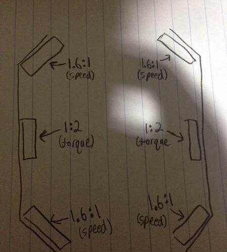

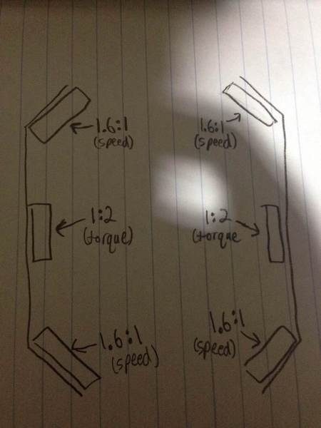

Here’s an idea I had a couple weeks ago that could be the best way to combine torque and speed without a transmission. I’m not sure if it would actually work but I might try it out if I have the time. Basically the outer 4 wheels are internally high speed geared, plus the 1.4:1 speed boost you get from x drives gives the chassis an overall gear ratio of 2.24. Then there are the middle 2 wheels which have a 1:2 gear ratio geared for torque. These wheels would be on a ratchet so that when the robot drives forward full speed the torque wheels don’t slow it down, but when there is a robot in it’s way it can use those 2 torque wheels to push them aside with ease.

I really like the idea of this, but even though it’s geared down for torque, It’s still only two motors pushing against an other robot with half as much torque, but twice as many motors. I would still like to see this go somewhere though.
Also, wouldn’t the holonomic drive decrease the speed you go at, since the force is being applied diagonally instead of linearly?
It actually increases the speed by root 2 (~1.41). I am not sure exactly why, but there have been quite a few post about it in the forum and I know it has something to do with the 45 degree angle and how it relates to a 45 degree right triangle (which has sides 1, 1, and root 2).
they should logically slow down the robot, if you draw out the triangle, where the hypotenuse is along the axis of the wheels, then the shorter legs will be in the X and Y direction, so Sin(45) = sqrt(2)/2 and so you get about .7, or 70% of the force in any axis
