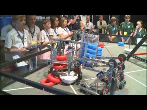

It seems unusual to name a wheel configuration after a team, but it’s the name that has been used in NZ by other teams and frequently at worlds, so I’m using it here.
The front two omni wheels are tank driven via chain from the motors at the back of the robot.
The motors for the back two wheels (strafe wheels) are sitting below the main drive motors.
The pneumatics are entirely unrelated.
This configuration is exceedingly useful for packaging the robot into a small base as it doesn’t require 6 wheels for holonomic drive. It also provides a large wheelbase to prevent tipping. Any problems with driving perfectly sideways can be fixed with code, and most drivers find the shallow arc to be useful when positioning the robot in front of goals etc.
Most importantly (at least for round up), the chasis doesn’t have anything in its center, meaning a robot with Lynfield drive can easily drive over round up rings.
Finally, the chasis has plenty of room in the center of the U for the arm and claw mechanisms.

A good demonstration of this chassis is the tv coverage of the finals of the New Zealand nationals, unfortunately lynfield loses as they are no match to goal lifting as we had not implemented this strategy yet but it is a good video of the strafing.

The problem with having the strafe wheels in the back of the robot is that it tends to drift when you strafe. In a standard H holo, the strafe wheel is near the CoG, so it pushes directly on the robot. Here, the strafe tends to pivot a little around the center, depending on how much friction you have on the front wheels. It is really hard to code for without a gyro because the amount of pivot you will have is not always the same.
While it doesn’t strafe in a perfect sideways line, in some ways that’s not that necessary. They’re agile enough to slip around the field quickly in any direction. I very much like this drivetrain.
A) during the game, the slight turning while strafing wasn’t a problem, I wrote a drive program that corrected for it, but jacko preferred the ‘real driving’ feel of doing the correction himself when he needed it
B) during auto it was more of an issue, I had to drive the front wheels slightly to keep it straight, but once I had figured out the speed ratios I needed between sideways and forwards drives for different arm positions, it wasn’t too bad
C) strafe wheels not moving us straight sideways meant we could use them to speed up our turning. It was FAST :smiley:
