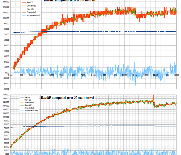

Thanks. I am using quads but the jitter is more like +_10% (about 100 RPM). I have a dual flywheel the two are separate. i am measuring ticks per millisecond which is then converted to RPM (I like working with bigger numbers.) I have made the flywheel as mechanically sound as possible, so i just assumed that was the jitter to expect. But if you’re saying ±10RPM then i am confused.

@Error404:Robot Not Found, you are correct, you get a :slight_smile: for catching a couple of sloppy mistakes in my post. Lets just pretend there is a magik “foo” sensor that reports w = 100 RPM when flywheel runs at its nominal speed and has no more than +/- 5 RPM of noise.
Seriously, though, past weekend our launcher speed control performance went from “quite good” to “borderline erratic” when technik jr changed delay interval from 50 to 10 msec while, at the same time, refusing to acknowledge the importance of handling roundoff errors.
Apparently, “not-your-TBH” code, that technik jr is proud of writing, becomes unstable over shorter intervals, when noise in the measurements exceeds some threshold. That was the reason, I run a number of experiments demonstrating the noise in the measurements to any denier.
Calculating velocity over 1 msec interval must be killing you with the roundoff errors. Here is a couple of graphs from the two experiments, where velocity was computed based on the difference between quad encoder readings over 5 msec and 20 msec intervals:
You can clearly see the blocky nature and significantly larger noise level in the experiment with 5 msec interval.
Since you asked not to post the entire code I will just give you partial solution, and let you figure out what else needs to be done:
