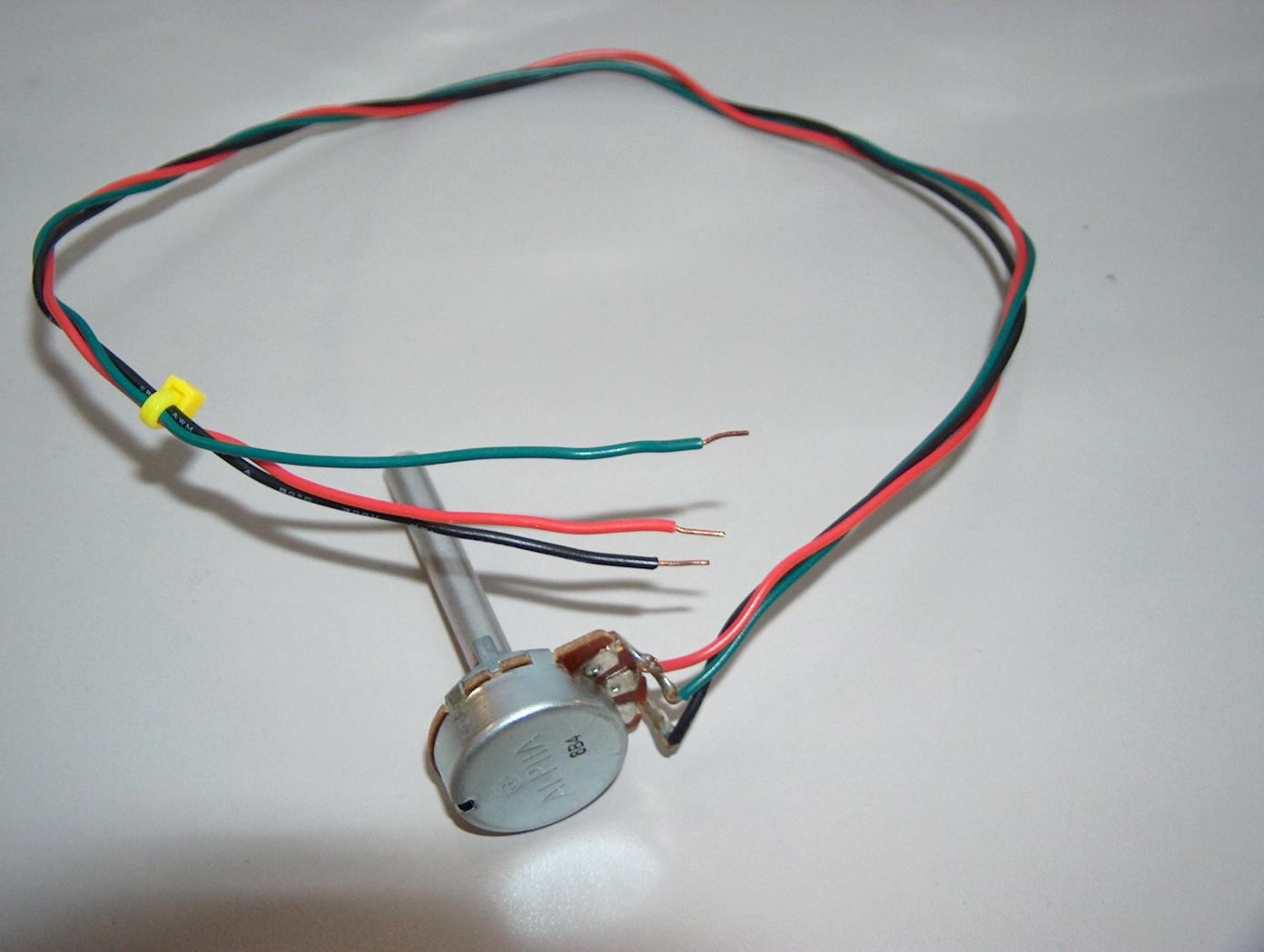

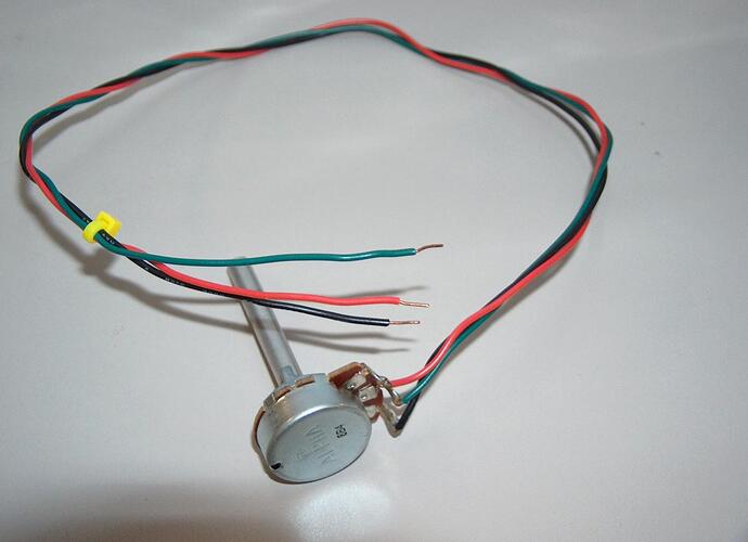

Here is a 100K-Ohm Linear-Taper Potentiometer, Radio-Shack Part 271-092. It’s $3.19 ( USD ), it has no Mount, or Easy Way to connect to the Shaft, but it will read just like the Official Vex one, because it is just a Voltage Divider.
Here is how I connect it to the Vex Controller:
[ATTACH]5992[/ATTACH]
On an Analog Input, the Green goes to the Middle ( Signal ), Always and the Red goes to the VCC and the Black to the Ground, or you can reverse the Red and Black.
For Basic Testing, or Choosing Custom Program Settings, these are cheaper than the Vex Ones, but not competition legal.

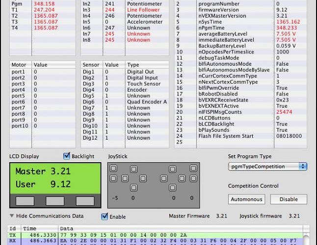

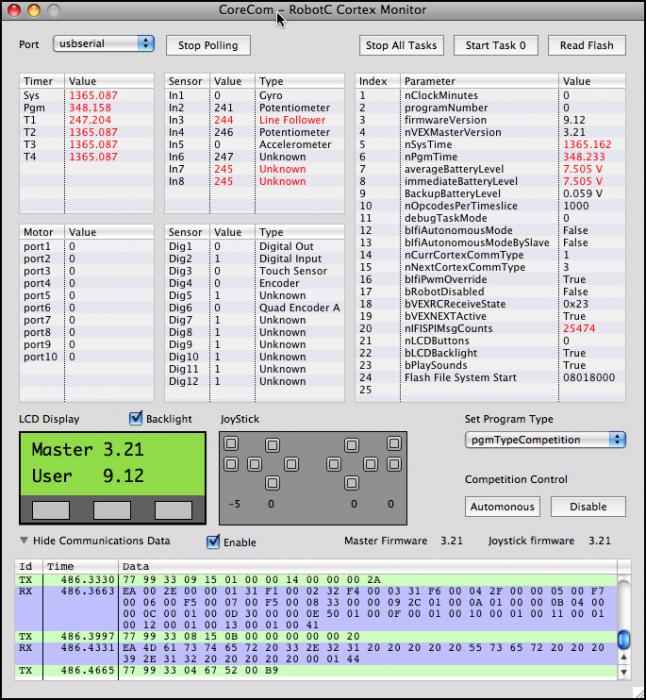

I’m going to link to a few old threads here to remind everyone what has been done before.
So you have a number of choices for PC to cortex communication.
First, I did a joystick emulator a few months ago and posted code here.
If anyone want to create a new program loader it’s pretty easy, the protocol is based on the STM32 USART bootloader app note AN3155, although with a little extra magic if you are using the serial programming cable, I touched on the magic in this post but I will leave the exact details out here.
ROBOTC has it’s own serial protocol that it uses after the virtual machine is running. Using this protocol pretty much everything on the cortex can be controlled. Here is a screen shot of part of my “corecom” software that I posted about months ago. Something based on this could “drive” the robot running software on a PC, reading the sensors and controlling the motors directly. Absolutely not competition legal but fun all the same.

Actually Kevin, both. Here’s some background.
I originally wrote this code for ROBOTC V2.32, at that time the cortex was still using the old style USB connection which was based on a Human Interface Device (HID). As I wrote this code primarily to run under Max OSX, I created a VEX HID class based on an existing HID class I had so the Mac could communicate over USB. I also supported the serial cable using the prolific driver on the Mac and, as a byproduct of this, could support the serial adapter with a PC version of the code.
When the master firmware was updated along with the release of ROBOTC V3.00, IFI changed the USB device to be a communications device class (CDC) and provided a driver for that on the PC side which (other than the fact that CMU changed many things in the protocol as well) allowed the PC version to work with the USB cable essentially for free. On the Mac side, OSX tries to use the new CDC device with a built in driver but, as the cortex does not simulate a standard CDC device, that driver would not work. Under OSX there are two ways of communicating with USB devices, you can either create a kernel extension (kext) or control them from user code which is the preferred way for most applications accessing custom devices. Unfortunately as the cortex thinks it is a CDC, the OS sort of hijacks the device and does not allow a user applications to access it. To get around this you have to create what is known as a “codeless kext”, a kernel extension that matches the USB vendor and product ids but does not contain any driver code. Once this is installed the USB device is accessible from a user space driver which is integrated into my application. The CDC USB works much better than the old HID USB used to, I would have preferred that IFI had made it a vendor specific device so I could have avoided the kext tricks but obviously use under OSX is not really a consideration.
The ROBOTC protocol is rather interesting. As we all know ROBOTC is based on using a virtual machine running on the cortex and a compiler that creates a type of intermediate machine code. Each different instruction is known as an opcode and will have additional data associated with it depending on what the opcode is. A line of code such as
bLCDBacklight = 1;
When compiled becomes the hex codes
11 11 09 01
The first 11 is the opcode for setting a byte value (opcdSetSourceValueByteConst), the 11 09 indicates the backlight.
The serial protocol is also based on these opcodes but wrapped in a message packet. The serial command for setting the LCD backlight is as follows (again in hex).
77 99 33 08 12 11 09 00 02 01 00 2F
77 99 33 is the message header
08 is a byte count
12 is the opcode for assign source value (opcdAssignSourceValue)
11 09 is the location for the LCD backlight
etc. (i forget all the details right now)
you can see all the opcodes in the header file OpcodeDefinitions.h
Once you figure out the protocol it makes a lot of sense and is easy to use, the trick is figuring it out :slight_smile:
The downside to this protocol is that it can change with each new release of ROBOTC. It was not intended for us to use but rather the ROBOTC IDE and debugger to be able to communicate with the VM running on the cortex. It’s mainly for this reason that I have never publicly released the corecom software as testing with each new version of ROBOTC and also check compatibility with all the old versions that may still be running is a bit of a chore, however, for my own use this is not much of a concern as if it breaks I just fix it.
