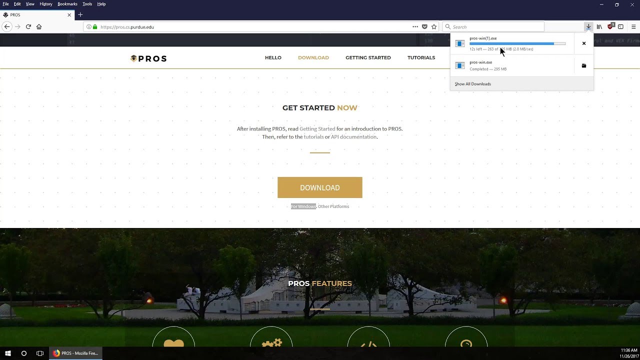

Ep 1: Downloading and Installing PROS (The beginning)
In our first episode, we download and install pros . . . and I ramble on about boring stuff while we wait around

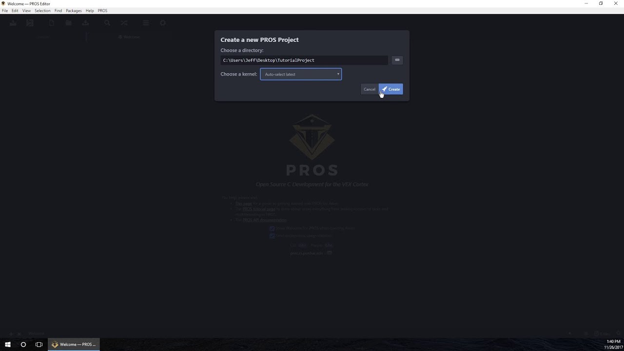

Ep 2: Creating a Project (Let’s get started)
In this episode we create a project and take a look at it’s structure - what files we care about and where our code gets written

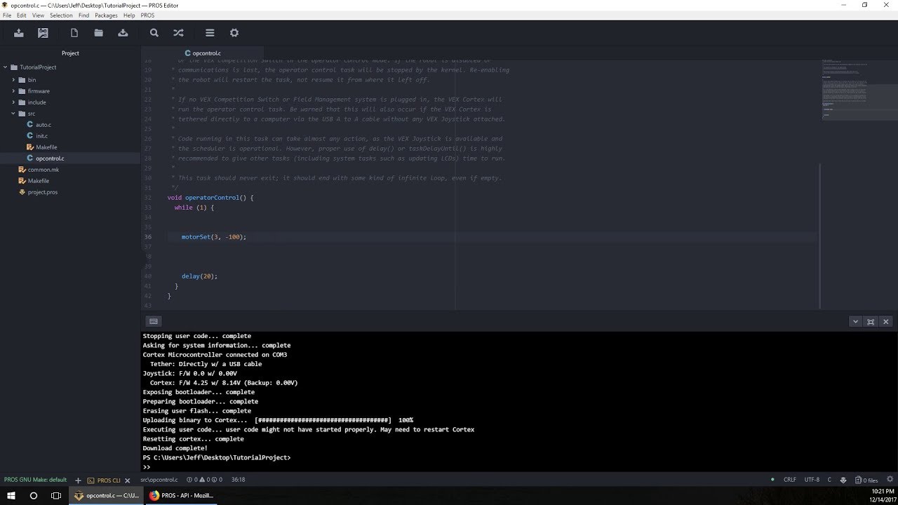

Ep 3: Controlling Motors (Our first code!)
In this episode we write our first code and make some motors turn

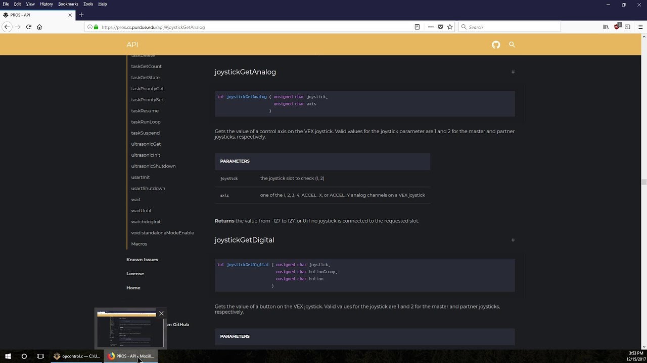

Ep 4: Reading from a Controller (Our first input source)
In this episode we look at the joystickGet commands and learn how we can use them to control motors.

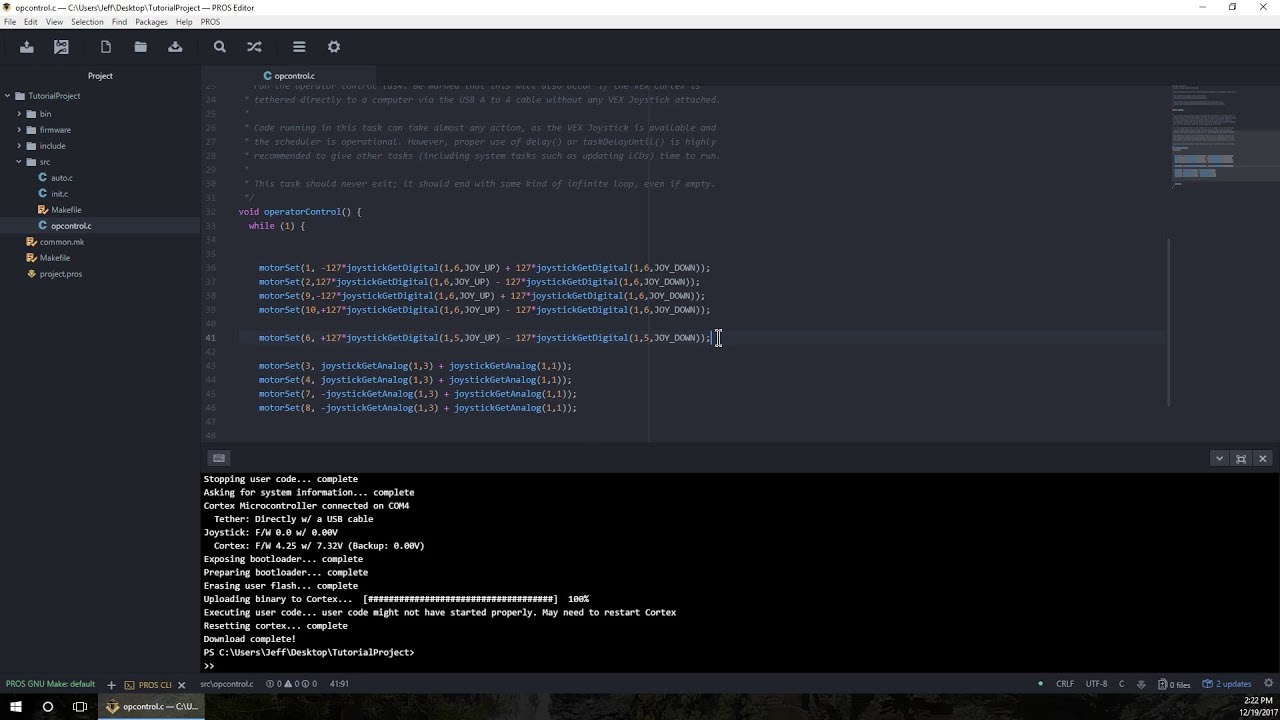

Ep 5: Base Driver Control (Tank Drive and Arcade Drive)
In this episode we begin writing our driver control code, starting with the base. We program two different drive styles: tank and arcade.
Ep 6: Lift and Intake Control (Adding 2 More Subsystems)
In this episode we add a lift and intake to our driver control program from the previous episode
Ep 7: Deadbands and Holding a Lift Up (with If Statements)
In this episode we improve our driver control program by using if-then-else logic to hold our lift up and to create a deadband for our base so the motors don’t whine

Not everything will still be relevant, but, as long as the student is not allergic to reading the API documentation, they can probably quickly figure out what needs to change from the tutorials in this thread.

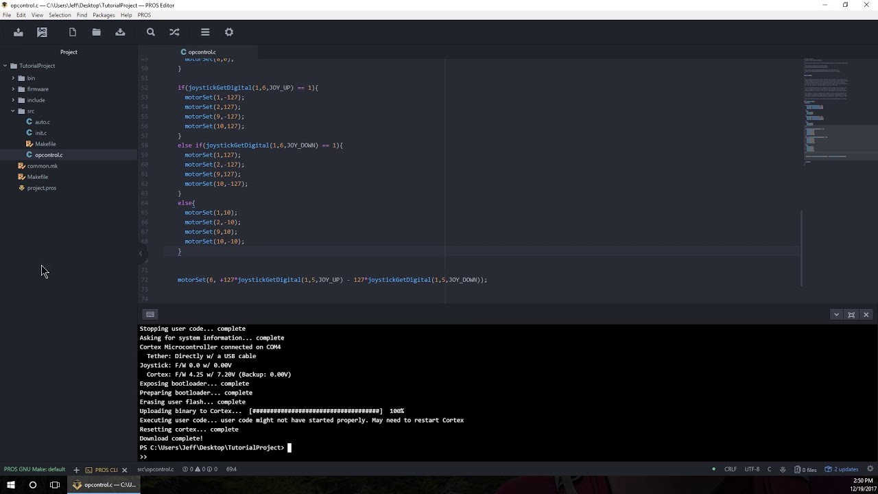

There are separate buttons within atom for compiling and uploading, but if those dont work then just open up a command prompt (assuming windows), cd to the pros project’s directory, then write
prosv5 mu
. ‘m’ is short for “make” which compiles the code, and ‘u’ is short for “upload”. If you want to also open a serial debug stream (which can be printed to within the program), then add a ‘t’ for “terminal”, so that your command becomes
prosv5 mut
If you need to download to a different slot, then first run
prosv5 make
, then run
prosv5 upload --slot SLOT_NUMBER
