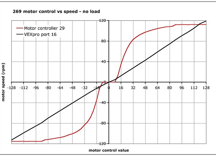

VEXpro motor speed tests
Following on to the testing recently done on the cortex comparing control value to motor speed, I though I would do the same test on a VEXpro.
The original data had been posted in this thread and specifically this post.
I tested a VEXpro in more or less the same way as before, a the cortex was used to measure rpm using an IME and speeds were set manually on the VEXpro via a GUI I’m developing for WiFI control.
Here are the results as compared to the previous test. VEXpro control values were normalized to be the same as the cortex.
[ATTACH]6136[/ATTACH]
Much better ! The VEXpro 2 wire ports control the motors (unloaded) in a much more linear fashion with excellent slow speed control.
The VEXpro is controlling the motor H-Bridge in a different way to the cortex and motor controller 29. The cortex seems to place positive voltage on one motor terminal and then switch the other to 0V at a varying rate, this is seen here.

I’m not sure if this simple change in drive scheme is the reason for the VEXpro linear response (I doub’t it actually), only being able to see schematics would answer that. I want to take a look at the current flow into the motor for both cortex and VEXpro next week (have a rather nice high speed current probe at work), perhaps that would give some more clues.

I was using a bench supply for these tests and used it’s ground. At one point I did look at the differential voltage across the motor but it wasn’t adding much to my findings.
When direction reverses the waveforms on the motor terminals swap.
Using back EMF to close the loop would be done in software, pretty sure libqwerk is not doing that and it is left up to the user.
