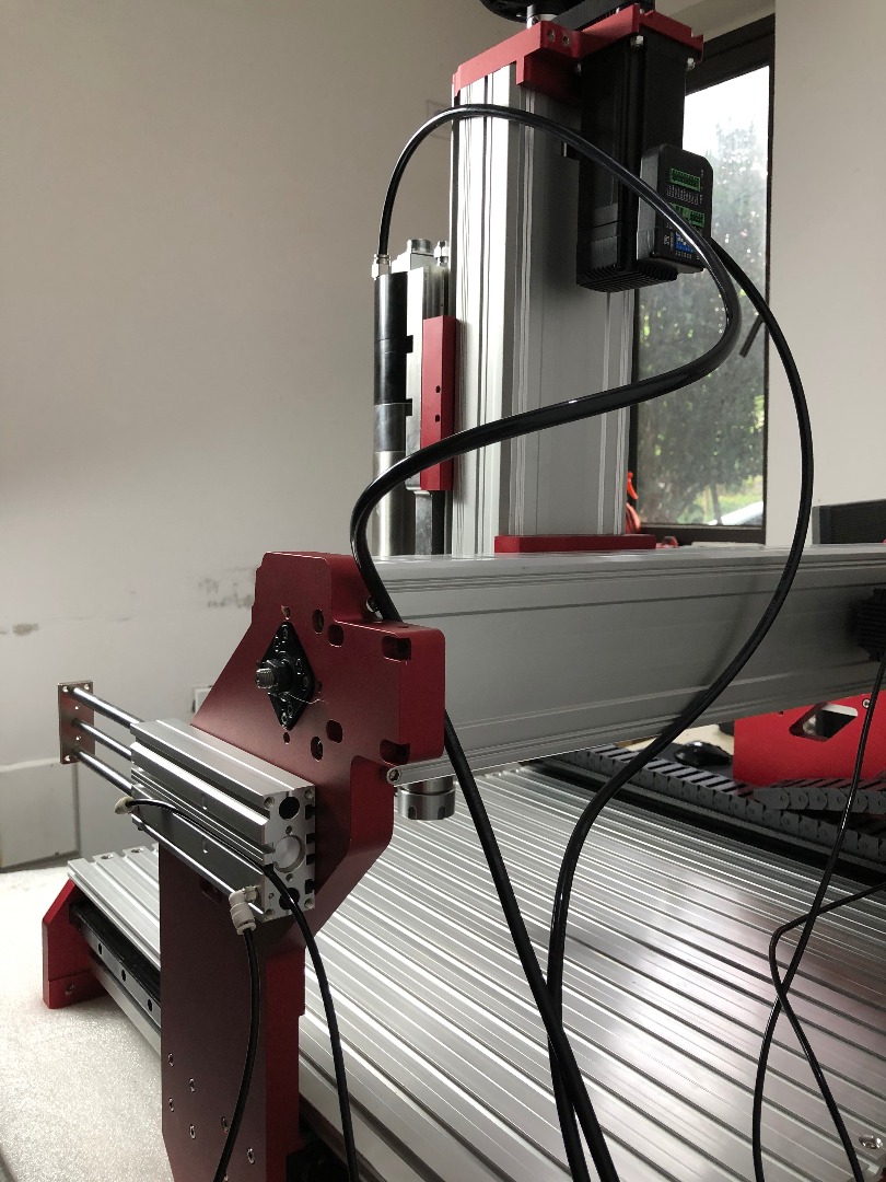

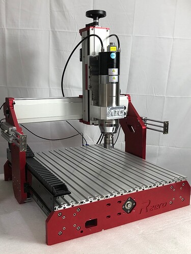

I recommend a CNC router, making a good G code, excellent cuts and very precise shapes can be designed. My machine also machines aluminum and soft metals. Although I have not cut polycarbonate sheets with it, good results are achieved. If anyone is interested, they can write to me personally.
I do have a CNC router in my school, it’s just that my coach seems to be against the idea of using it to cut polycarbonates.
