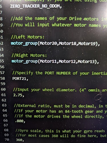

Hello everyone, Our team has been using JAR template for our robot this season, however we have recently been having a repeating issue with our inertial sensor. Every time we try to turn in an autonomous, the sensor will start spinning endlessly, and when we check the inertial sensor on the brain, the heading is continuously ticking up. This only happens in autonomous, and it stops if we switch to driver. We have tried rewiring the sensor, moving the sensor, repacing the sensor, factory resetting the sensor, and even switching the brain, and nothing works.
If anyone has any ideas on what is happening, any help would be greatly appreciated.

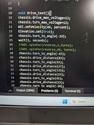

we are having the same issue. The robot will not turn to correct amount of degrees at all. We have 4 motor tank drive. The robot will make the first turn correctly but it will not make the correct turn after that. Robot will make the first correct turn (angle 292) but it will not make the correct second turn agnle 240. Help please?
Are you expecting the second turn to be a 52 degree turn or a 240 degree turn? How much does the robot actually turn for the second turn?
Trying to turn 240. Sometimes it turns to 240 and other times it spins and stops on a different angle (not 240).
If you look closely at the name of the function turn_to_angle means that the turn will be to the angle you specify. this is relative to the starting orientation of the robot. Think of the values of 292 and 240 as if they were a compass heading. If you want the robot to turn 240 degrees the second time, you’ll need to set the heading 240 degrees from your current heading, I believe.
