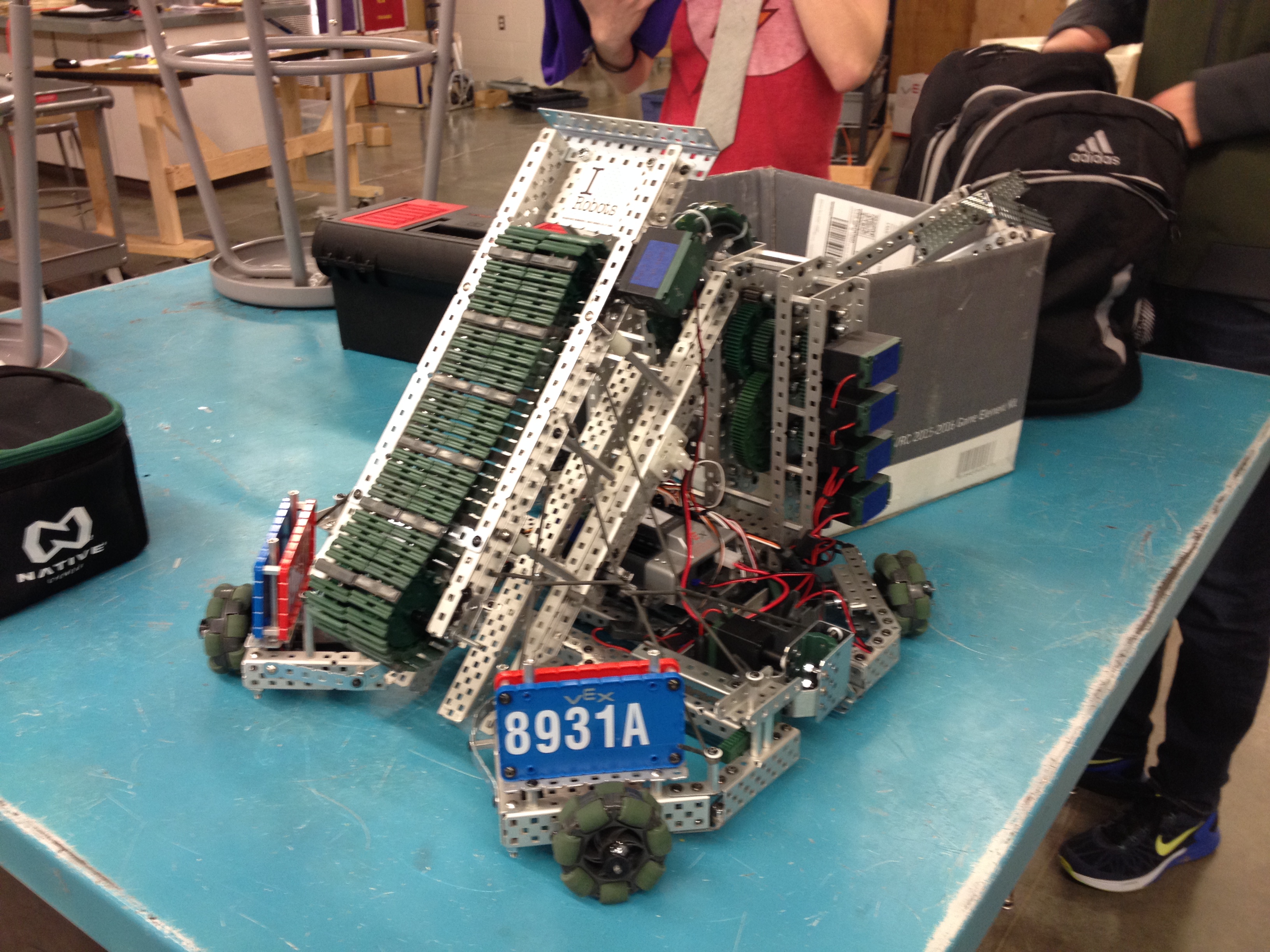

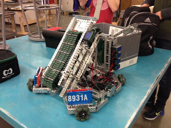

I have standoffs with bearings on top, I just swivel the bearings out, plop in the license plates, then twist the bearings to hold them in place. but I’ve seen Vex IQ pegs used to easily cover up red plates with blue, or vice-versa.

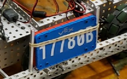

We use two standoffs mounted on the robot with two rubber bands on the top and bottom. The only picture I have of it is just one rubber band closer to the center, but usually we use a rubber band on the top and a rubber band on the bottom of the robot for mounting the license plate. We just use VEX IQ pins to attach the two license plates back to back and take the whole thing out and flip it when we need to switch. However, while the license plate has never fallen off, I do think there are better solutions like the one @2775Josh posted.

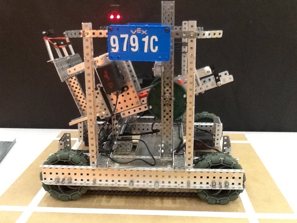

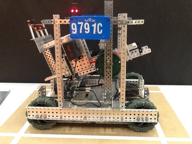

Here is how my team attached our license plates back in NBN. There are two long standoffs attached vertically, and then small standoffs connecting each corner of the license plates. The plates simply slide over the standoffs and can be easily flipped around from match to match. This worked for us for multiple seasons, and we never had any problems. Hopefully, this helps!
