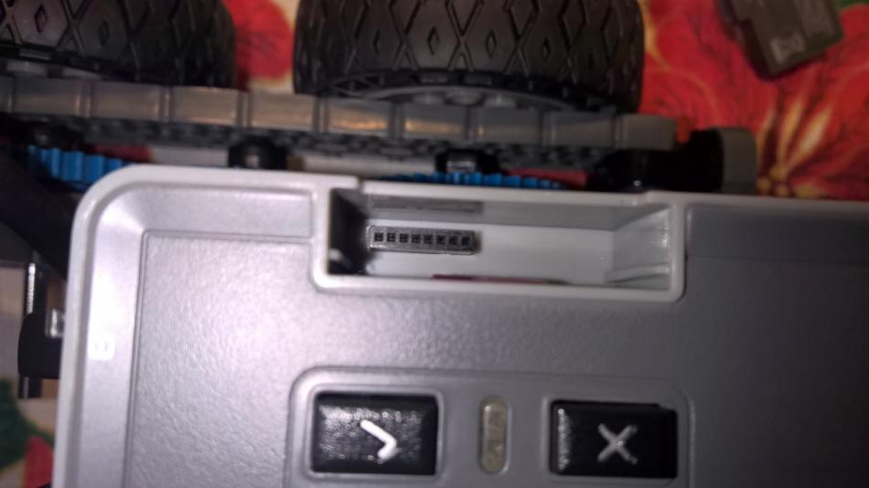

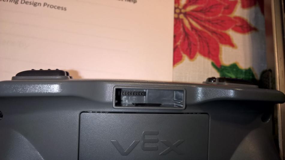

I just got a super kits to involve my son in the STEM environment. I built the basic robot, charged my batteries, and connected everything. I followed the directions to tether the brain and the controller, but when I unplug them there is no wireless symbol in place of the tether icon. I have updated firmware for the Brain and the controller. My radio modules (900 Mhz) are both installed at the moment of firmware upgrade. I pressed the up to the end the sensors in the brain and the controller (if I push harder I will broke it). There is a different between the Brain and controller wireless antenna sockets. The socket of the controller is around 1mm dip that the Brain’s socket (see pictures). I have searched the Internet for an answer. I know that I can control the robot using the theter cable but, it was not what we want. My kid is upset.
The fact that the wireless symbol is not showing up means the radio is not working. That could be a bad radio, bad brain, or bad connection. The last is very common, which is why we often suggest making sure they are inserted all the way.
Assuming the radio is fully inserted in the brain and still not working, I would suggest swapping the radios and try the other radio in the brain.
If that still doesn’t show the wireless symbol, you should contact VEX Tech Support.

Hardware side: As explained many times in this forum, it is hard to seat the radios properly. Besides that, I had to repair one of our school brains, as the connection pins were smashed by repeated insertion attempts. It turned out the black plastic housing the pins inside the brain got stuck tightly in the radio module and some of the pins didn’t fit on next attempt, bending 3 of them.
So, please check which version of the radio do you have, which firmware version does your brain runs and verify both that you’ve got no uncovered, broken pins in the module slot and that the module is fully inserted into the slot
