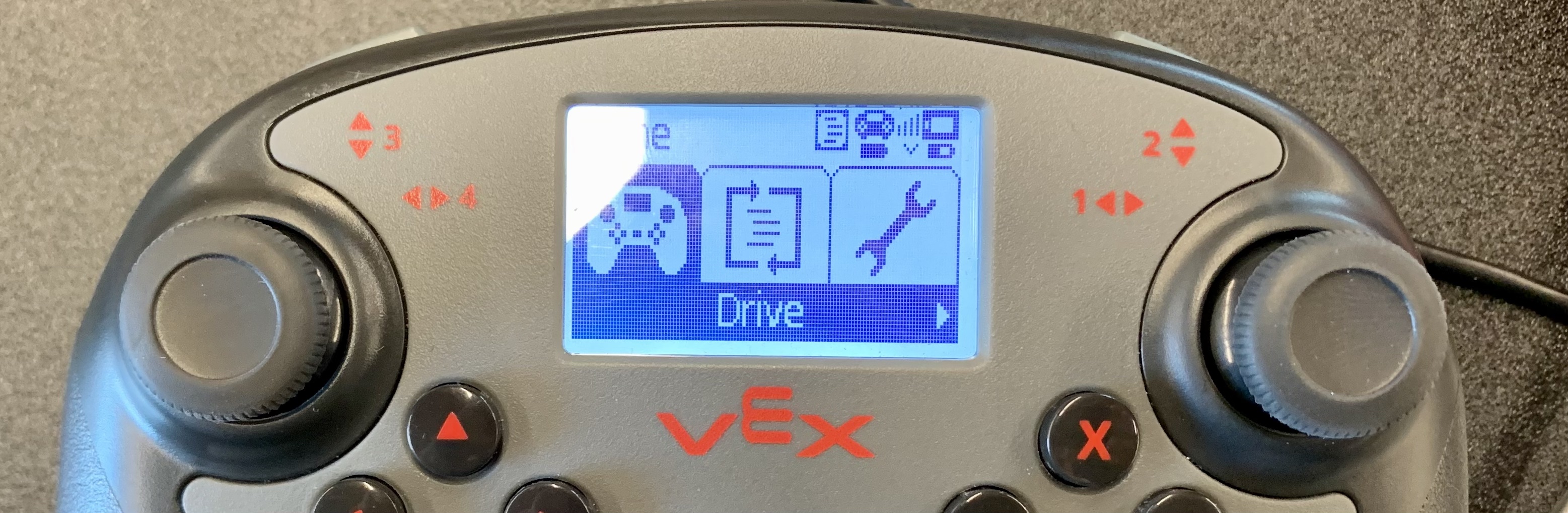

I have a V5 controller that is stuck and will not allow timed runs or skills runs. I have reset the controller and its firmware is updated. It has a symbol we are unaware of it. Any suggestions?

That symbol in question is the field controller autonomous icon, so the controller thinks that a field controller or competition switch is telling it to run auton.
Will the controller do an autonomous timed run?
It could be a similar issue to these threads:
IIRC, check the pins in the ports… make sure they are nor shorted due to a wrong cable being plugged in.
